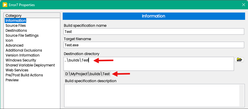

I' m not the author, but I can understand the needs to have relative path, which goes up outside of the project folder — this might be useful for multiple projects, building PPLs in monorepository, but this one is still relative and not absolute. In general depends from source code's organization.
In additional, just from usability point of view — even if used inside of the project, this relative path appeared to be absolute.
For example, if my sources located in D:\MyProject\src and build is located in D:\MyProject\build, then I also prefer to have "..\build" here instead of "D:\MyProject\build", because in fact this is relative path appeared as absolute, but if I will move project to another location, then it gets changed automatically, and for me this is a very strange "design" decision. I also prefer to have this like in MS Visual Studio. So, if I enter truly absolute path, also within the project folder, this should stay absolute and should be not changed under any circumstances, and if relative, then stays relative, that is.
In ideal case I would like to see  both - my entered relative path and somewhere below this field - how it currently resolved to the final target destination:
