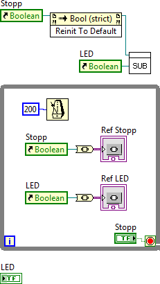

I can't see how the whitepaper you posted is related to my problem. I'm hitting errors on Property Nodes when gaining/releasing control of a VI via LabVIEW's Remote Panel capability.
However, i've elaborated the problem and now it seems like I don't just get Error 1, but also Error 1055: "Object reference is invalid" repeatedly. This happens when _gaining_ the control of the VI, contrary to OP's original description. If it happens, the Property Nodes in the while-loop of my last example generate Error 1055 endlessly and the GUI on the remote side won't be updated (the LED won't blink/flicker). Here, the solution of just clearing the error, as suggested in this thread, is not helping, because my GUI on the remote side won't update at all.
It seems like random whether I'm hitting Error 1 or Error 1055 or an error at all. Sometimes I have to gain and release control for only one or two times to hit an error, sometimes it takes 10 or more tries.
In conclusion, I don't think this is intended behaviour and would be very glad if someone could guide me on how to use the combination of Property Nodes + Remote Panels in LabVIEW.

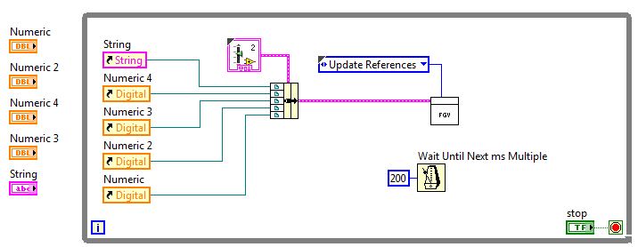

A simple method may be to run a loop in the main VI that just passes the control references into the FGV:
The SubVIs can access the references with a get command.
I would recommend making a cluster of all the references and putting it in a typedef to simplify future updates.

Thanks for the fast reply and sorry for the late response (time difference :D)
I tested your method and first of all I wanted to see whether the References actually change in the while loop. I wired them to a Variant Indicator but the Refnum stayed the same the whole time, even if I gain/release control of the Remote Panel.
I captured it on video:
http://youtu.be/TKngF4NGDjQ
(Also, in the video, you can see how after some tries of gaining/releasing control I hit the recurring error 1055 and the Sub VI stops working (LED not updated))
If I continue and wire the References to a FGV, this won't be updated, as the Refnums don't change. Is there another way to obtain the changed References?

Main VI:
Main VI

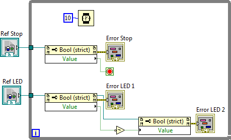

Sub VI:
Sub VI
