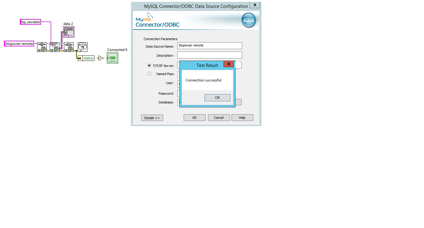

My Labview hangs everytime i execute this program to connect with a remote server. May I know why ? I tried to use a local host on the same listening port and it works perfectly fine. Both remote and local are using the same listening port. not sure if it will affect
Thanks.
