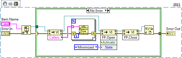

Closing the callers was the "missing piece".  Here is the routine.  If it is not in memory, it throws an error which I clear in the Error case (not shown).  Otherwise, I enumerate its callers, recursively call itself to close each of the callers, then open and close the routine (if it isn't open, trying to close it will throw an error).
Incidently, while posting this, I thought I'd be "clever" and call this VI on itself -- a bad idea, as it starts an infinite recursive chain ...
