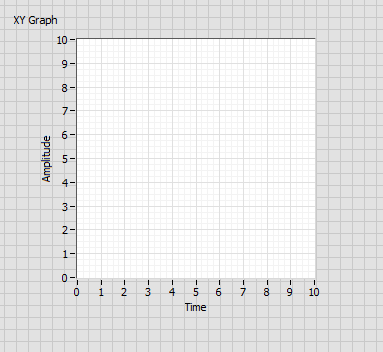

Attached is a file, i would like to remove on the front panel the chrome on the graph. The chrome is the graph's raised step  and the plot icon.

I'm assuming you are showing an XY Graph.  Try replacing the XY Graph with the XY Graph from the Classic Palette -- it has neither the raised edges nor the default Plot indicator.  You can also get rid of the Plot Legend by right-clicking the Graph, choosing Visible Items, and unchecking Plot Legend (which is unchecked, by default, on the Classic Palette).

     Attached is a screenshot of what I mean.  It does work but the classic template doesn't allow for removal of plot tab.

Now you want to remove the frame around a graph and hide the plot legend?
Starting with a Silver XY Graph
Use the color picker and make the frame transparent.
Then right click on the chart and turn off the Plot Legend (under Visible Items)
Is that what you want?

      Yes, that is what I want. Attached is the vi attached.
