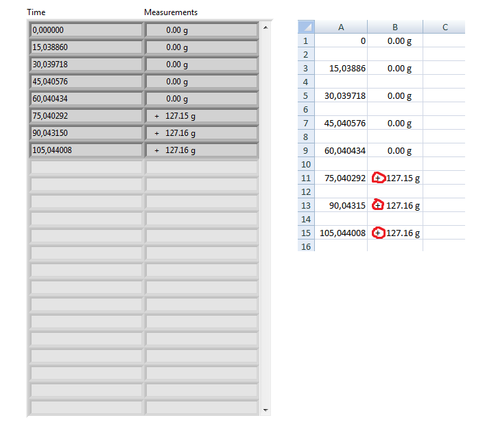

Hello dear Labviewers. I need to calculate the values in excel, and can't do that with those "plus" symbols. Is there any way to remove them from Excel ?. The problem occurs because my scale can measure both positive and negative values in grams. Show.png

it seems you send strings to the Excel sheet. You have to convert those into numbers, either in LabVIEW or in Excel...

atleast you should remove the "+" as well as the unit ("g") from your string delivered by the measurement device.
Excel doesn't recognize a string like "+ 123.4 g" as a number, instead it formats that as a string - and Excel can't calculate with strings!

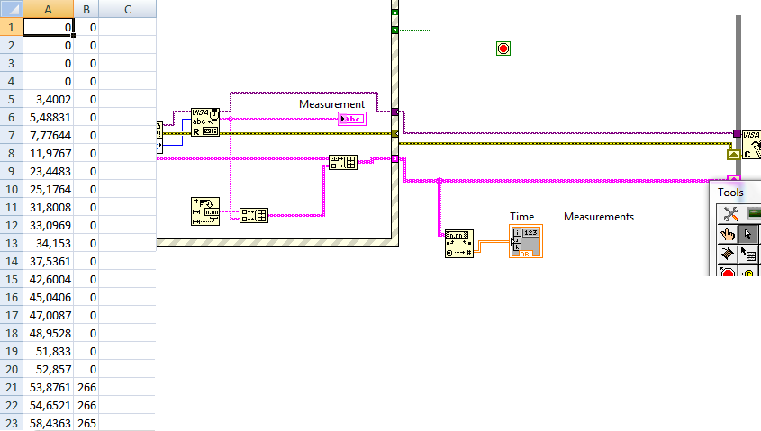

I have converted to a number, but the layout of the excel document isn't as good as before.
Can i make a headline for both time and measurement columns in excel, and how do i do that ?

something does not look quite right...
You are cvonverting a double to string, then back to an array of doubles..
Can you show the rest of your code (or post it)?
And you can add more columns..  Your image does not show what you write to file..  or Excel..  or Spreadsheet file...
