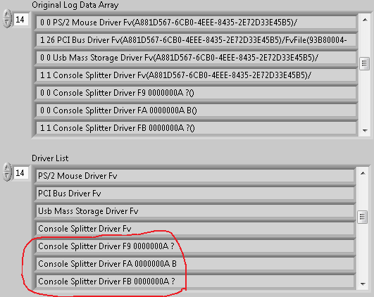

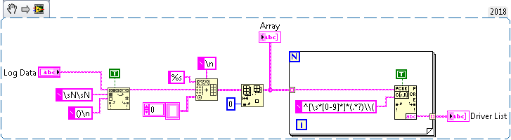

Is this what you are looking for?  If so,... It almost works.
I noticed that the drivers in the list were separated by "N N" and I used that in the Search and Replace function. There are a few exceptions in the results. I needed to append "()" to the to account for lines that did not have any parenthesis. However, those lines ended up with some residual numbers/characters. It appears that it is an 8 digit hex followed by a space and another letter or question mark. It shouldn't be that difficult to remove.
Another exception I seen was "<null string> Fv".
EDIT: attached the vi (version 2014)

"^[\s*[0-9]*]*(.*?)\\(" probably should be "^[\s0-9]*(.*?)\\(". The first matches (from the beginning) 0 or more whitespaces, *'s, ['s, numbers 0-9, then 0 or more ]'s.
It still works of course...

Another question - is there any difference in these drivers?
Console Splitter Driver Fv...
Console Splitter Driver F9...
Console Splitter Driver FB...

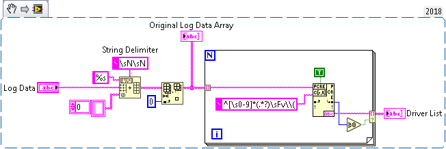

If you want to reference only one of these instances in your list, then you can get rid if the Search and Replace and do it this way instead.
