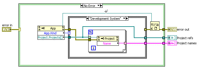

Anyway, if you want to programatically rename VIs in a project, yes it is possible and actually not very complicated.
Basically you need 3 steps :
While the project is opened get the project reference :
Then find the item (VI or other type of item) by name to get its project item reference :
Then rename it :
Hope this helps

Thanks TiTou: I did manage this same solution. The trouble I was having was that I renamed a .ctl file, and then the other VIs did not see it anymore. My solution was to use scripting to replace that control in the calling VIs. Renaming within hte project (non-programatically), did not cause this same problem. Or at least I don't think it did.
