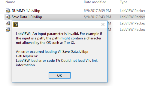

I have a post-build action in LV2014 that renames a packed library after the build, appending the build's version number to the packed library's filename, and incrementing the version number of the build. This has proven to be an easy way to maintain packed library versions and ensure the correct code is being distributed in our test system.
In LV2015, this breaks the library. I have confirmed that programmatically or renaming the packed library breaks the library. An error dialog is generated that indicates the VIs are being searched with an absolute path involving the library's original name.
In the image you see that GetHelpDir.vi is not found, which is not called in this library directly, AFAIK, but any VI called may appear in this dialog. Save Data.lvlibp was the original name of the library, but it was renamed Save Data 1.0.lvlibp, and thus this VI is not found.
Why would this be?

The error message is pretty clear, the lvlibp links to other vi's including the lvlibp's name. What you'll need to do is build and use a Pre-build VI that changes the name of the target in the project before building.
Check Get Build Specification Version and Set Build Specification Version

I would argue there was a bug with 2014 and fixed with 2015.  The VIs in the PPL have a logical name set to the name of the PPL.  If you rename the PPL, then all of the VIs have an invalid name and they cannot recompile to use the new name.
