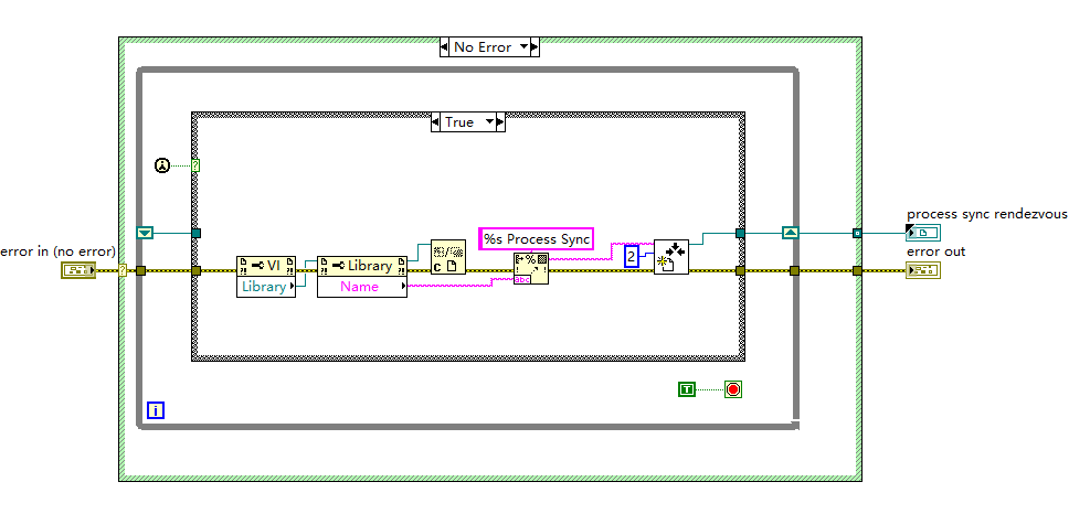

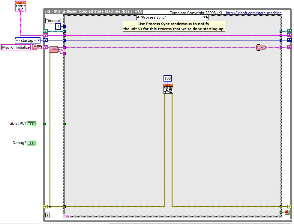

Rendezvous sync function used in this VI, what is the meaning?
I found this sub-VI called "Process Sync" and had difficulty in understanding it. Could anyone tell me what it's doing?

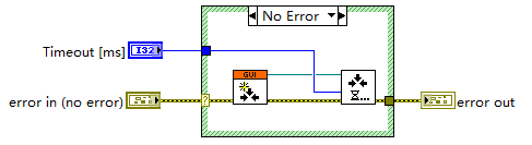

GUI is like this;

This makes only sense if you have parallel executing VIs. One is "Init.VI" obviously, which requires synchronization with the rest of the application.
Hence you pickup a Rendezvous from an FGV and wait for the two VIs to meet in the Wait for Rendezvous.
Tip: Search for another "Wait at Rendezvous.vi" in your project.
