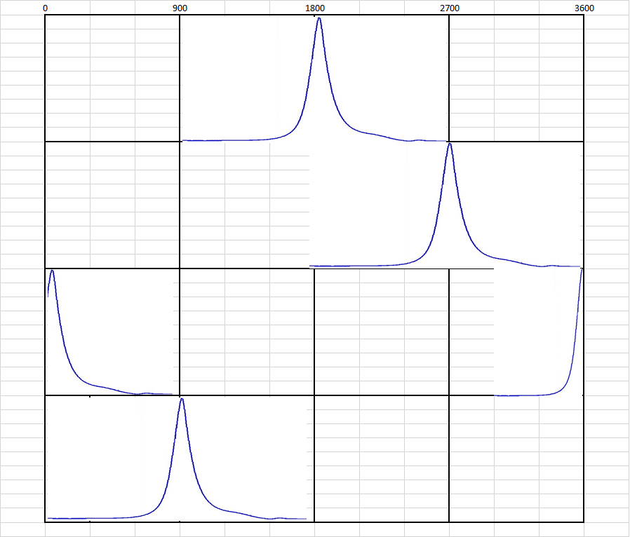

I have 4 input signals in my FPGA which look like this:
The signals are saved independently in arrays (size: 3600). The first signal is centered around 1800 and I would like to reorder the others to also be centered around 1800. There is a fix delay between the signals, so my first option was to created a "for" loop that  "point by point" reorders the array. The signals correspond to pressure traces from all cylinders of an internal combustion engine. Is there any other way to reorder the signals? Maybe using defined functions in labview...

Use Index Array to break up your 2-D array into the individual channels.  Use Rotate 1-D array to rotate each 1-D array however many elements necessary to get the peaks to line up.  Use Build Array to put the individual 1-D arrays back together into a 2-D array.

Hi Pablo,
the use Raven's suggestions to rotate 3 of those 4 channels to the correct position…
