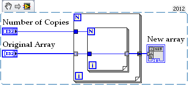

I would use Initialize Array.
Message 6 of 8
(3,896 Views)
Or, if you want to be fancy, turn the digit array into a string, use search-and-replace (2X) to add your digits, then turn the resulting string back into a number array.

Most cleaner and simple solution has been posted by crossrulz
