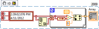

I don't have some of your subVIs. Let's make it simple:
  1. Add an indicator after the transpose operation (see image)
  2. run the VI so the indicator contains data
  3. change the indicator to a constant, still containing the data.
  4. delete the code to the left of it, including the transpose operation.
  5. save VI under a new name and attach.

Hoping it will work now.

What of you would just do it in the inner loop?

Worked fined, but I had to increment the number of loop iterations by 1, in order not to cut of the last row of the array! Seems like it is working fine now! Thanks a lot for the help!:D

I was just wondering if I could bother you with one last question. I have added some code, in order to interpolate between some datapoints, and then multiplying this with the transposed array that you just helped me with. I then want to find the total sum for each column, but when I do this I end up with an 1D array of only 60 elements. I guess it should have been something like 180 elements (one element for each column). Do you have any idea of where this come from?

Well, most of your code is overly complicated and a lot of it makes no sense. For example your inner FOR loop on the right repeats the same calculation 200x. Once is enough!
Here's a quick draft, also simplifying the interpolation. If you want to sum in the other dimension, just remove the transpose operation as indicated.

Thank you so much! You are truley a master of LabView!:)
