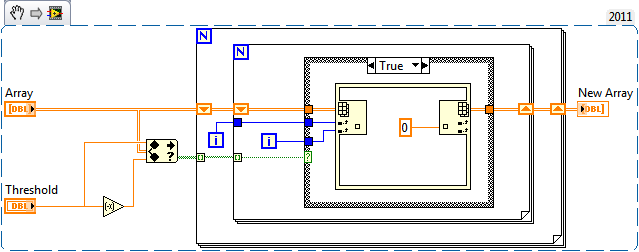

Thanks Taki1999. That's the first thing that came to my mind too - see my similar VI attached below. It works, but I thought surely LabVIEW should have something built-in that would be faster. In my case "large" means something on the order of 1000x1000 (I am working with images).

This might be a little faster since it's not hitting the terminal on each iteration.
I also think Absolute values tend to be slow mathematical operations.
Message 4 of 12
(4,412 Views)
I just did that too. Smiley Happy It doesn't seem a whole lot faster when I test it with a big array, but I agree that it should be a little faster. Thanks again for your help!

This approach appears to be a little more than twice as fast as the Select approach.  I tested it with a 1000x1000 random array of values between 0 and 1, with a threshold of 0.1:

Alternate method.
Ben64

I was also about to suggest the idea Ben shows - I think that's fastest.  Also, if your image is only positive numbers then you don't need to perform the Absolute Value function, which will save some time.
Based on my benchmarks, the methods have the following performance with a 1000x1000 array of values between 0 and 1, with a 0.1 threshold:
Taki9999 - 35 ms
ben64 - 25 ms
Darren - 15 ms
I ran these benchmarks in LabVIEW 2011.
