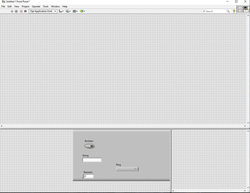

Hello I have attached a VI which has a splitter at the bottom and a decoration and some front panel objects like this.
resize front panel decoration and objects.jpgresize front panel decoration and objects.jpg
I want to resize this automatically when I change screens. My laptop screen is small but I am using a different monitor. When I unplug from the monitor and use 100% my laptop screen, then I cant see this. How do i automatically change this. I have attached the VI. Kindly help me. Thank you.

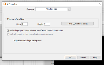

you also need to go to each panel (right click on the pane) and select Pane sizing > Scale ALL objects with Pane
(2,068 Views)
I cant click on this because it is disabled. Why is that. Thank you.
(1,994 Views)
It is disabled because it says it applies only for single pane options. Mine has four panes.
