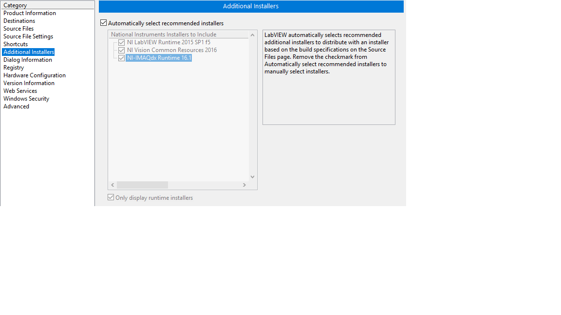

I have an application which uses Imaqdx pallete. It works fine in development environment.
Now I would like to create an installer.
First I create a .EXE and then I create an installer succesfully.
in additional installer I check this:
So apparently libs of imaqdx are included.
