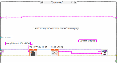

JSLI global:image.pngimage.png
Picture of JSLI node on block diagram:

I found a much easier solution, I forgot that the reason I used JavaScript for websocket was to give everyone easy access to the data.  Well duh, NXG WebApp covers that now. Here is what I replaced the JavaScript Node with (problem solved, I don't have to learn so much javascript):
