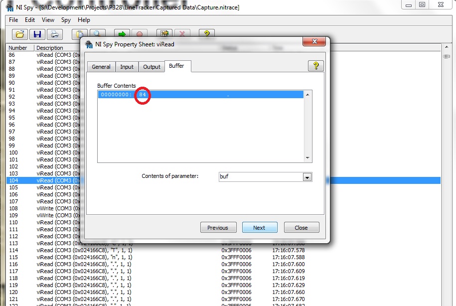

I have an .exe application that communicates with an instrument.  The .exe includes a GUI with a few configuration options, then acts as a data logger once the instrument is running.
I'd like to use LabVIEW to fully automate this instrument as part of an automated (and un-manned) maufacturing process, configuration and datalogging.  There is no addtional information available from the vendor.
Does anyone have experience to share on the best approach to this type of task?    Attached are data grabs from NISpy and the corresponding data exported from the GUI application.  The setup of the serial link is obvious, but I don't see the data.  Is "...CTk...."  the data in an encoded format?  Would Portmon to similar sniffer software provide more information?

how can I extract the NI Spy buffer data to a spreadsheet?

discovered you can change export options to include buffer data.  Now using match pattern VIs to strip the data from the txt file with LabVIEW.

I've got the data using NI-Spy, did look at portmon tho.  The interesting part now is finding the data, last time I designed a serial link, to avoid having the start byte in my data, I used only a portion of each 8-bytes for data.  When you reverse engineer somone else's work, it's hard to know what part of each byte is actual data, then from that what is low-high, msb lsb etc...
