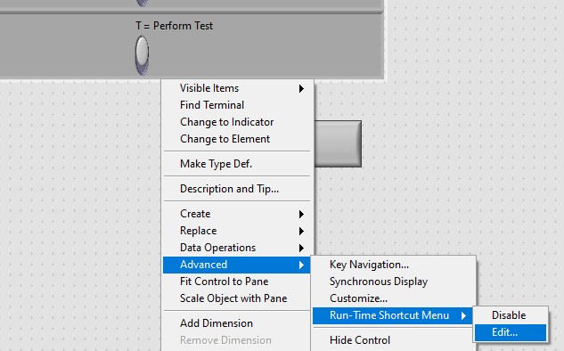

To edit, make sure you right-click the very edge of the array, then select Advanced -> Run-Time Shortcut Menu-> Edit:

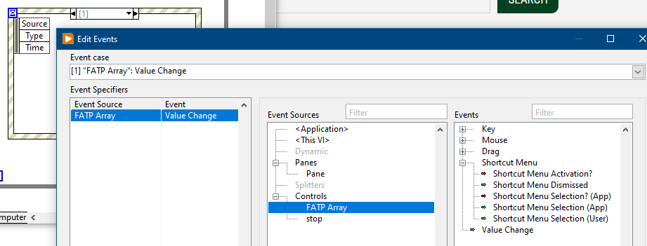

To activate anything you add to the menu, create an event structure, then create a case for the array, then the shortcut menu, then the appropriate sub-event:
"App" is for anything built-in.  The one with the question mark allows you to cancel the built-in functionality.
"User" would be for anything you add to the menu manually.

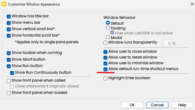

If you need the only these, then you don't need to customize menu, this is how it looks by default in run-time:
Be sure that the defaukt menu is enabled in VI props:
