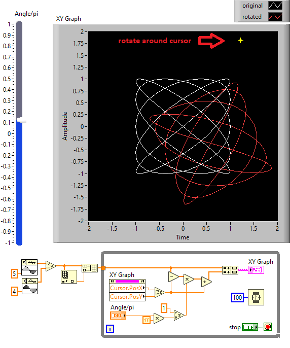

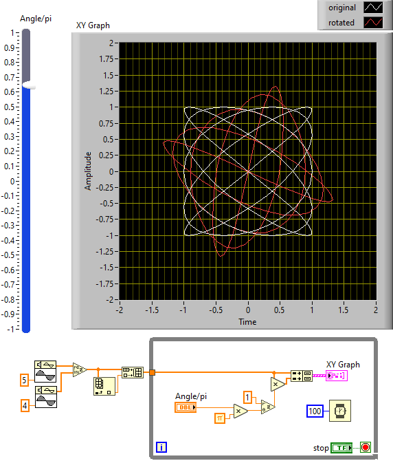

@GerdW wrote:
then simply apply basic complex math by changing theta to "rotate" around a certain point in your XY plane…
Or just multiply with a complex number (r=scale, theta=angle). Also make sure to not autoscale the axes and size the xy graph so the x and y scales have the same range and length (i.e. square gridpoints) to avoid distortions.
(To rotate about an arbitrary point, flank the code with an subtract/add of the center RE/IM complex point. Not shown)
(2,929 Views)
