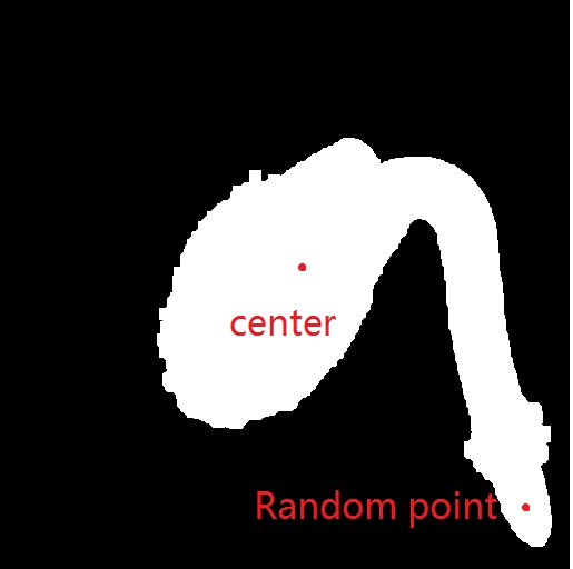

Imaq Rotate.vi is to rotate an image around its center point (correct?).
I need to rotate an image by a user-specified point in the image. What I have in mind is to expand the original image so that the specified point becomes the center of the new image, rotate this new image, and trim the image back to its original size. Is this the right way to do it? Or I am making it too complicated?

Whether you rotate about the center of the image, or any other point in the image after re-dimensioning the image, the angle of rotation is the same.
If your goal is to preserve the original image dimensions you can wire a T to the maintain image size boolean.
If your goal is to end up with the red dot in the middle, then resizing before rotating is the quickest path.

A rotation does not change the shape of your image. If you apply IMAQ Rotate on your image by e.g. 90 degrees clockwise, you will get a satifying result.
Your approach would introduce more effort than required. Especially "trimming back the image to its original size" should make the resulting image look very close to what IMAQ Rotate is doing. So I would stick with IMAQ Rotate.

No, my goal is not to keep the random point in the center. The goal is to rotate the image around the selected point. The end result is every other pixels are all moved but the selected point.

I know Rotate.vi won't change shape, but when you rotate an image around a different point, the relative positions of each pixel will be different. That's why I wanted to rotate by a random point, instead of the center point all the time.

You mean that the "selected point" has the same absolute coordinates at the end as in the beginning? Simply use the IMAQ Rotate like they are telling you to, then translate all of the pixel coordinates by the negative of the X and Y distances that you moved this pixel in the first place (easily calculated by the distance from the nearest corner before rotation and the size of the image, so you don't really have to locate it again).

I am not able to follow you. Rotate around the image center first and then what? Where do you feed in the 'selected point'?

You can calculate the center point of the image and you know "your point". When using IMAQ Rotate, you can also calculate where "your point" will be in the reulting image. That's all you need to go further.

All right. First, do you want your "selected point" to have the same absolute coordinates in your new image as in the original? If yes, keep reading. If no, all that follows is irrelevant.
In the following discussion, you need to bear in mind that I have not used NI Vision stuff, but the Vision functions seem to be very straightforward.  It seems NI has made it easy for you.
The first thing you have to do is determine the X,Y coordinates of the point you want to rotate around ("selected point"). I'll leave that to you, since you've got to pick a point somehow.
From the dimensions of the image, the coordinates of your point, and the angle you want to rotate your image through, calculate the X,Y vector that you will "move" your "selected point" along your coordinate system if you do a simple rotation.
From the Image Manipulation subpalette of the Vision Utilities palette, use the IMAQ Rotate function to rotate your image hawever far you want.
From the same subpalette, use the IMAQ Shift function to translate the entire image back along the vector you determined 2 steps ago to put the "selected point" back where it was originally.
If that doesn't do it, it's probably impossible Smiley Wink .
I don't know how to break it down any better than that.
