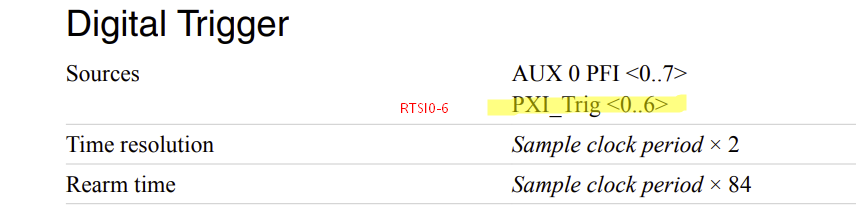

PXIe-5172 oscilloscope has RTSI interface. Does that mean it can't listen to PXI-Trigger signals on backplane? If not: What is the recommended way of hardware triggering my scope from a generator event without using front PFI connectors.

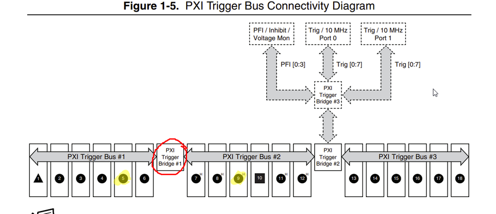

Chassis PXIe-1095
Trigger Bus 1 : 1-6 Dynamic
Trigger Bus 2 : 7-12 Dynamic
Generator Slot 9 H
Scope Slot 5

Yes, I do agree that the PXI SCOPE does not have RTSI but I believe it will be equivalent to PXI_TRIGx based on what I observe for FGen.
As per the Scope spec, it does support PXI_TRIG0-6 which maps to RTSI0-6 (if my understanding is correct)
Historically, these PXI instruments were PCI based and hence the driver still calls them RTSI but so far all the instruments I have seen directly map the RTSI number to PXI_TRIG number for PCI/e and PXI/e counterparts.

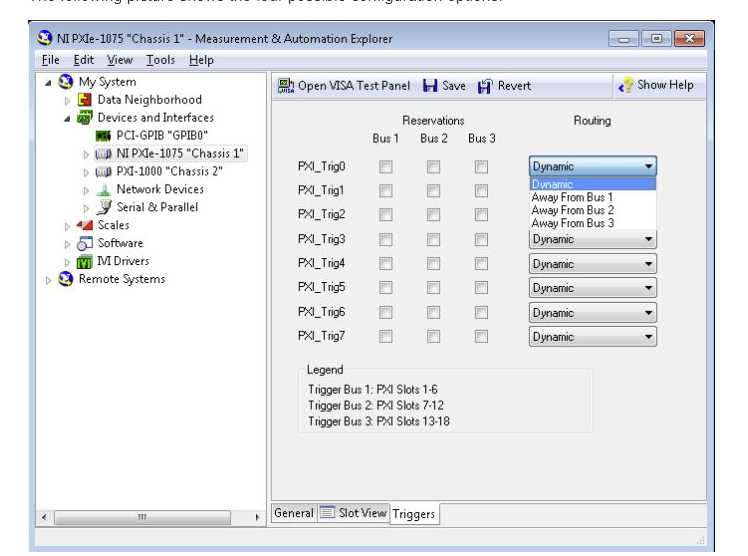

Now, both your instruments are part of different PXI busses and you need to configure the PXI bridge to route the PXI_TRIG line across.
Since FGen will be the trigger source, configure the PXI_TRIGx as away from Bus 2 in the triggers pane of the PXIe-1095 chassis in NI MAX, this would bridge the PXI_TRIGx line from away from Bus 2 into Bus 1 and 3.
https://knowledge.ni.com/KnowledgeArticleDetails?id=kA03q000000YIIVCA4&l=en-US

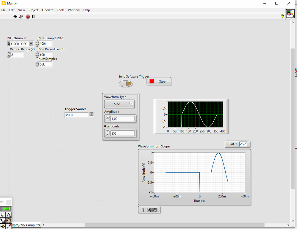

Hey, I am not sure if it works now.
I followed your instructions and I receive a graph. I expect the trigger at around 0 ms. The scope shows the waveform I expect after 0ms.  So are those samplings before 0 ms some kind of pretrigger samples?

Ok, I had to adjust the reference position in horizontal timing.
