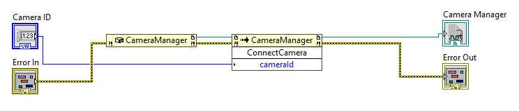

When I run this function using a console function, it works perfectly fine.  However, when I create a VI wrapper around this function (see below), I get a Run-Time Check Error.
Specifically, I am getting the following message each time I open or run my VI.
I have debugged this a bit, and have narrowed it down to when to I call the function below.  In other words, if I comment this line out, along with any other line after it, the VI runs fine.  However, if I attempt to execute camera.Connect(), it gives me this error.
camera.Connect(cameraGuid);
Is there any way to fix this issue from LabVIEW's perspective?  I don't have the ability to modify FlyCapture2d_v140.dll as that is closed-source.

Nevermind, apparently switching from the debug version of the library to the release version of the library fixed it.  This StackOverflow question was helpful.
http://stackoverflow.com/questions/9308858/dll-error-flycapture
I'm still curious to why that might have happened.  Thanks!
