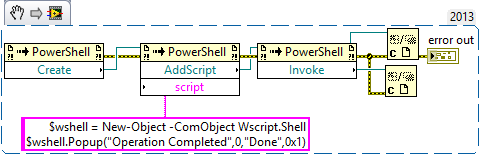

For powershell you can use .NET:

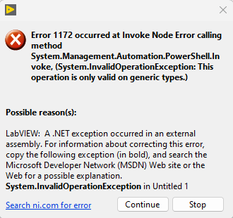

I'm seeing the following when attempting to run your code. I can't find any documentation that suggests what might be causing this. Any assistance you could offer would be greatly appreciated!
