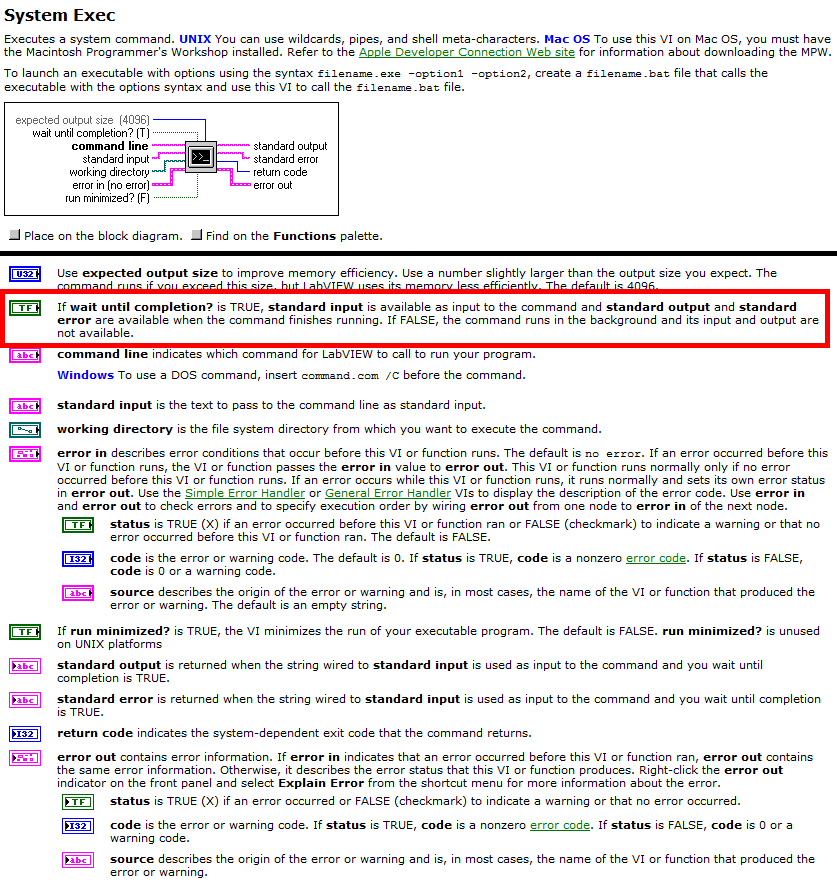

Gave this a go + the previous comment too (run as administrator for elevated rights) but neither worked. However I think I’ve found the solution and it is quite funky to me.
There is the input “Wait for competition?” and till now I always had it on true since this is the description:
To me this clearly means that I must have it as “true”. I messed about in LV2015 to test what is up. And I accidentally set this to false -> And magic happened, it works. Even though the description states that if it is false it’d run in background. But it looks like it is the opposite….
I’ll test with this some more and if it really does work this way I’ll accept this as solution.

As mentioned, the VI won't return anything until it is done. I think that's what is wrong. If 'wait until completion' is true, and the executable never finishes, the VI won't finish, and basically 'hang'. If it is false, the VI will return directly, but won't have any output strings.
Run in the background means it's running and the VI won't wait. 'background' might be deceptive in this context. It's not related to the ordering of windows. Both wait until completion false and true support run minimized, those options are complementary.
