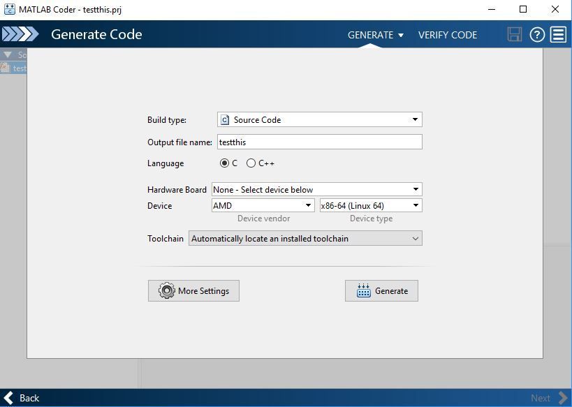

1) Create a shared library (dll, so, something else) using Matlab, which targets the exact processor and operating system that the myRIO uses (see image below).  Matlab also creates the .c and .h files if you would like to use another compiler.  I may have skipped over some detail here but that discovery is part of the fun.

Here is a screenshot of the Matlab Coder showing that it isn't too much work to target the myRIO's hardware configuration (I don't know the myRIO so I this may not be the exactly reflect it's hardware).  There are several other settings that you can play with, e.g. choosing row-major or column major, and it may be required to do this to get this to work.
An example of using the Matlab Coder to select the target platformAn example of using the Matlab Coder to select the target platform

Do you see where it says:
Device: AMD      x86-64 (Linux 64)
If you can't make this read:
Device: ARM         arm-eabi (Linux arm-eabi)
or something along these lines, then you won't be able to target the myRIO hardware.
The settings you show "MAY" (with a big may) work for the cRIO-903x series which use an Intel x86-64 CPU but not for the myRIO which uses a Xlinx Zinq chip with integrated ARMv7 core.
