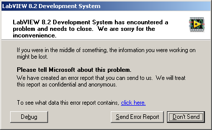

This is crazy!!  We talk about this and all of a sudden, LV crashes 3 times in a row because I am replacing 2D arrays with 1D arrays!!!
Life in the Twilight Zone!!  <<< sorry to hijack the thread >>  Thought it would make someone laugh... (not me 😠 )

haha you just gave me a mini heart attack. I had opened this thread and left the room, when i came back in, all i saw from a distance was the Labview has crashed dialog on the screen...and I hadnt saved in a little while, PLUS I had just got my program working, so I thought it still had mystery bugs! As I started to read it I thought WOW this is super weird! I dont even have 8.2!! But then I realized what had happened...and I didnt even need to call an ambulance!
