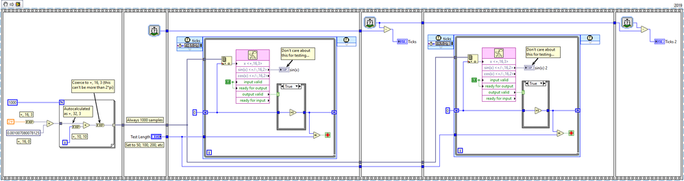

I'd be curious to see if this behaves more like you'd expect:
Here you should be able to compile this once, and then run it with different input "Test Length" values.
See if the Ticks produced are more linear (I'd expect there to be some offset that you could identify in both "Ticks" and "Ticks 2", and then a scaling value like (L+16)* iteration period).
Don't set Test Length to less than 1!
Edit: That snippet has cycles/sample at 16, so probably the time will be 16*L*period, not (16+L)*period. But you can play with the throughput setting too (would require recompiling the bitfile though, urgh...)

Hi cbutcher
I tested your code this morning, this is what i have:
Length = 1 Tick40MHz= 18 Tick80MHz = 21
Length = 10 Tick40MHz= 162 Tick80MHz = 93
Length = 50 Tick40MHz= 802 Tick80MHz = 413
Length = 100 Tick40MHz= 1602 Tick80MHz = 813
So, it means with 40 MHz clock:
High Troughput Sin take effectively 16 ticks to execute and while loop take 2 ticks.
with 80MH clock :
High Troughput Sin take effectively 8 ticks to execute and while loop take 13 ticks.
So i guess the SCTL works as expected, ( I just dont understand why the 80 MHz Timed Loop has a greater overhead). It's just the method to do the measurement that was false....
thanks a lot for your help !
