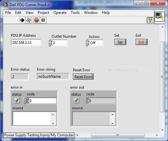

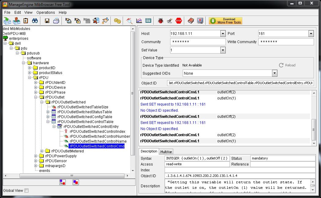

I'm brand new to SNMP although I have used LabVIEW a couple of times over the last few years. Right now I am developing an application to test power supplies. We are using a Dell G756N switched PDU to power each supply. I've tried a couple of approaches to controlling it, and SNMP is the most promising so far. During my research I came across ManageEngine's free MibBrowser and I was able to find the latest MIB in Dell's firmware download here. I have been able to communicate with the PDU and turn outlets on and off so far, but I really need to integrate the PDU control into the LabVIEW application to automate the testing. I came accross Mark Yedinak's SNMP communication library and his APC PDU examples, the latest of which I have found are in this thread.

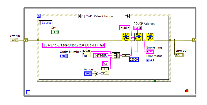

I tried to make a VI to test the communication in LabVIEW using the OID I got from MibBrowser, but it returns an error code of 2, noSuchName. The PDU is set to use v1 of SNMP and both the public and private communities have write+ access. I have tried it with and without the leading period, but without any success. I am using LabVIEW 2013 64-bit. Could someone please look at the information below and see what I might be doing wrong or what direction to take to troubleshoot it?

MIB Object ID:
.iso.org.dod.internet.private.enterprises.dell.pdu.pdusub.hardware.rPDU.rPDUOutlet.rPDUOutletSwitched.rPDUOutletSwitchedControlTable.rPDUOutletSwitchedControlEntry.rPDUOutletSwitchedControlCmd
.1.3.6.1.4.1.674.10903.200.2.200.130.1.4.1.4.1 : {1 or 2}
I added the .1 at the end for the index of the first outlet, and the 1 variable is instant on, while the 2 is instant off
VI:
Front Panel:
Wiring:

I'm using the same OID that is listed in MIB Browser, and MIB Browser is able to successfully communicate. Is there another tool that translates better? I've seen references to MIBs that aren't standard, and maybe that is where the disconnect is happening, but I don't know how to identify a non-standard MIB.

I've switched to LV2014 32-bit and installed Wireshark. I'm still getting the same "noSuchName" error, but using wireshark it lists the packet sent by SNMP as a "Malformed Packet". I'm guessing that somewhere in the depths of the VIs something is wrong, but I'm not sure what. I created a small program to save the output of the MIB Walk VI and that ran fine. The OID that I am sending is listed along with the correct type of variable.

Comparing the "Outlet 1 Off" packet from MIBBrowser (MB) and my LabVIEW (LV) program:
  • UDP packet length on MB is 62, is 61 on LV, definitely a mismatch.
  • Both SNMP portions start at the same offset
  • SNMP version looks good in both packets
  • Community string in both packets looks good
  • both packets define the packet as a set request, although the LV on is one hex shorter
  • Set request ID on MB is 2, on LV is -7295. Seems strange, bears further investigation.
  • The Varbind List Type looks okay. Note that it starts one place later in the LV packet than the MB packet due to the size of the request-id in the LV packet.
  • The Varbind Type and length is correct in both packets (30 1a)
  • The OID is correct in both packets (type:06, length:15, value (2b 06 01 04 01 85 22 d5 17 81 48 02 81 48 81 02 01 04 01 04 01)
  • The value in the MB is correct (type: 02 [integer32] lenth:01 value: 02), but the LV packet only has one hex: 00
