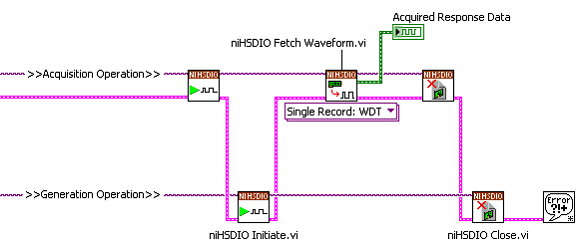

The acquisition operation must be started before the generation, as shown in Figure 10, to ensure that the acquisition is armed and ready to receive the Start trigger before generation begins. The final optional step is the analysis of the acquired data, which you can use to make a simple pass/fail decision. Rather than go into the software analysis of the acquired response data in more detail, the following section looks at how to use the real-time hardware compare feature to do this analysis more efficiently then can be done in software.
Figure 10. Ensure the Acquisition Is Ready for a Start Trigger Before the Generation Begins

I'm looking at your code and I see that you have two acquisition sessions while the example has one acquisition and one generation sessions. This could be the reason behind the error.
