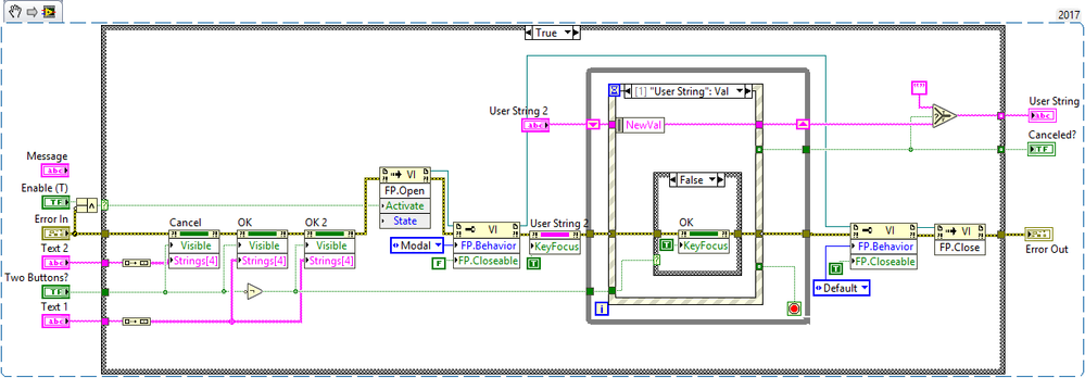

The other way around- is in fact to have a modal dialog that is modal to the LabVIEW application instance with the key focus set on the input parameter and the "enter boolean" receiving focus with any enter (\r or \n) key received.  Sort of just exactly the way Prompt User.vi is configured.
Or, you can use this:
Which has some advantages over the built in Three Button Dialog at the cost of not "Magically" resizing buttons when you localize the button strings and the buttons need to grow because "OK", "Cancel" is "Bewilligt", "Stornieren"  in Germany

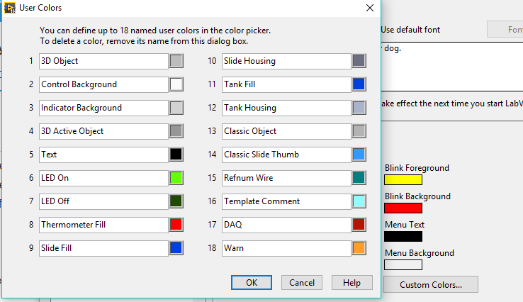

As for [colr] - Again, on the environment page colors section select "Custom Colors"
use any string defined here
Menu>>Tools Options Opens a LabVIEW Ini editor
Blink Speed is set from the Front Panel Page
Blink Colors are set from the environment tab Colors section.  UNCHECK "Use Default Colors right click Blink FG or B and the color picker pops-up. Choose what you want. (or something close)  You can fine edit the ini keys by hand if there is an exact RGB value you absolutely must have.
