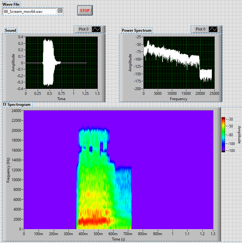

There's definitely something wrong with your code -- too bad it is in NXG, as my expertise is in LabVIEW Classic (for want of a better term).
A colleague sent me a .wav file of a primate "scream" and wanted to see its Spectrum.  I wrote a little VI that read the file, passed it through an FFT Power Spectrum VI to get the overall Power Spectrum (the sound lasts about a quarter of a second), then sent it through a Time-Frequency Spectrograph VI that produced the following:Time-Frequency Spectrograph.png Note that the Frequency scale is Linear, where as in your Post, it is logarithmic.
It doesn't look like you attached all of your code (not that it doesn't matter to me, as I can't look at the NXG functions to see if you are using them correctly, but someone who understands NXG and has it installed might be able to spot an error if you included all of your code).  If it helps you, I used 25 Time Steps and 2048 Frequency Bins to create these Spectra.
