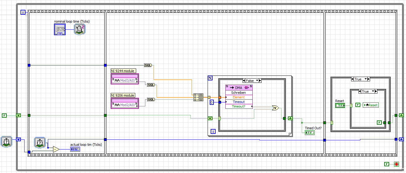

Now I like to sample data on the FPGA put it into an DMA to Host FIFO and do further processing on the cRio controller. The FPGA VI looks like this:

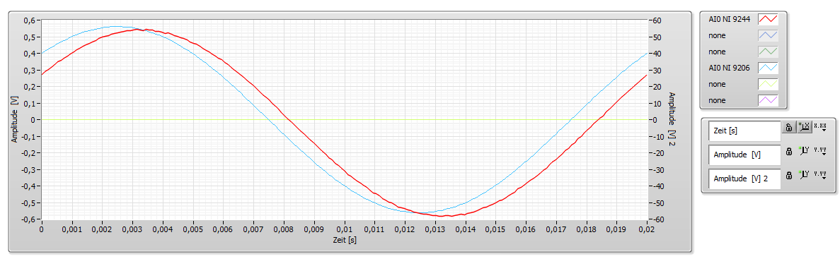

My the problem is that there is always a considerable delay between sampled signals of both modules of about 0.6 to 1 ms as you can see on the following graph:
This delay keeps constant during program execution. There is no further drift. So I wonder why this happens?

What you are seeing is an inherent property of using a Delta-Sigma type device.  The value you can retrieve from the device is always a little stale due to the unavoidable delay in the conversion process.  When you request a new conversion from your 9244, the value you get back is what the signal *used* to be a little while ago.  There's a formula for this delay in the user manual on pg 37.
I know that even with DAQmx and Windows  it can be tricky trying to sync data streams between "standard" DAQ cards and Delta-Sigma cards.  I'm afraid I don't have the FPGA background to have any particular insight there.  Just confirming that what you're seeing is indeed expected behavior.

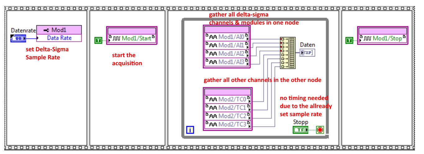

perhaps this explains what you are experiencing and by the way I added a screenshot of how to sync Delta-Sigma modules with non-Delta-Sigma modules.
How Can I Compensate for Different Group Delays with C Series Modules in LabVIEW FPGA? - National Instruments
https://knowledge.ni.com/KnowledgeArticleDetails?id=kA00Z000000P8cOSAS&l=en-US
Why Is My Data Delayed When Using DSA Devices? - National Instruments
https://knowledge.ni.com/KnowledgeArticleDetails?id=kA00Z000000P8toSAC&l=en-US

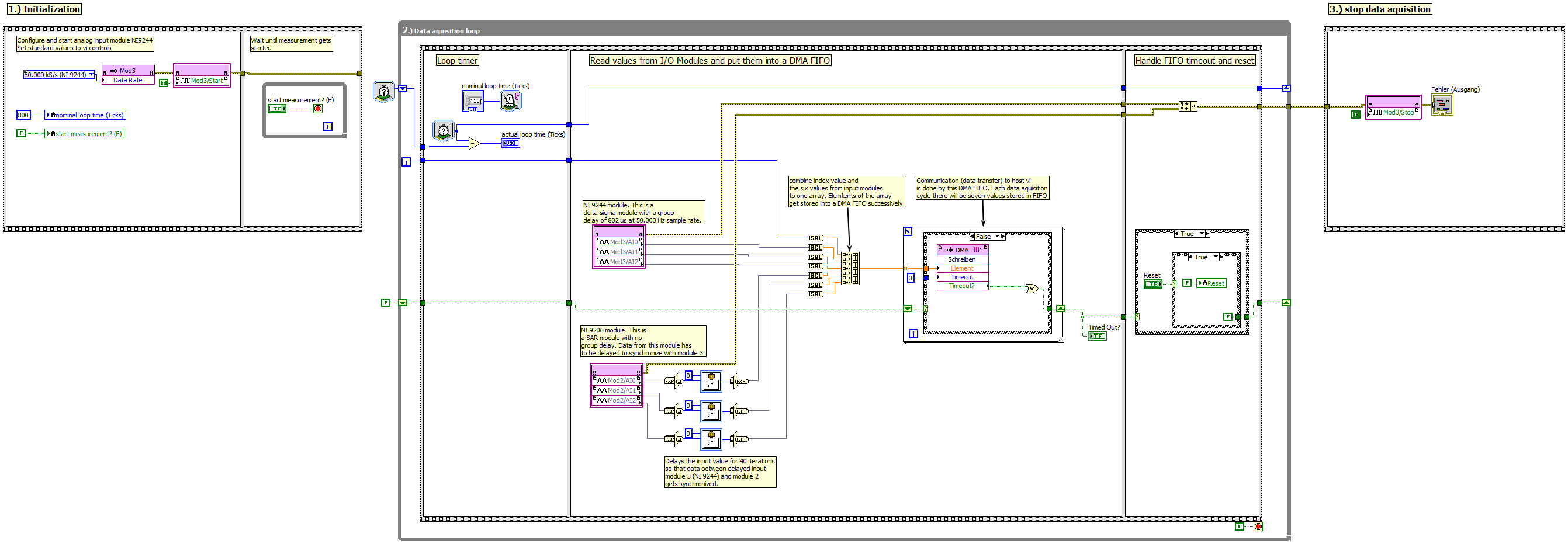

Thanks a lot for your great help. With your hints I was able to solve my problem. I feel a bit embarrassed haven't seen the information about input delay in the data sheet. Unfortunately it is not so easy to find this information for someone who started developing with cRio and NI delta-sigma modules for the first time. Furthermore I read a lot in the NI cRio developers guide - in particular section "Synchronizing Modules". On page 120 there is the same hint then you gave Christoph (put both I/O-Nodes in one data acquisition loop) but this is not enough to get values of the same "timestamp" from both modules. To realize that I added an extra delay to the data from the faster SAR module of 40 cycles. I have configured cycle time to 800 ticks so the delay of 40 cycle results into a time delay of 800 microseconds. That’s the input delay given in the data sheet of the delta-sigma module for a sampling rate of 50 kS/s.
Now I can measure and see two sine signals that both overlaps perfectly. In the end my FPGA vi looks like this:
