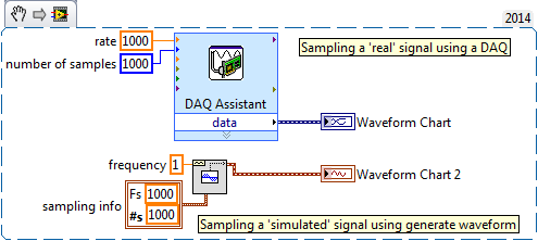

Using an NI DAQ device there are no other 'sampling techniques'. If you look at the vi snippet below, you see that the DAQ vi outputs a sampled signal just like the generate waveform vi. You don't get to do any sampling yourself or use a 'sampling mechanism', just change the input parameters to the vi to tell it sample rate, etc.
Therefore, I'm not quite sure what you are looking for (and obviously neither is GerdW who was actually trying to be helpful).
If you are looking to observe what happens when you change the sample frequency for a given waveform (in order to experiment with aliasing, etc.) then you can take the given samples and 'downsample' using the Resample Waveform vi.
