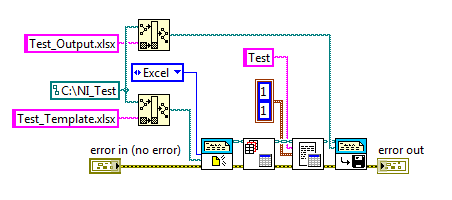

It's been an ongoing issue when using this Save Report to File VI. I'll open a template, output all my information to an Excel report, then attempt to use this Save Report to File VI at the end. I watch all my data get dumped appropriately to the report, but the process ends in an Excel file that is open with my report, is still "named" as the original template file it was built off of, and the user must then manually select File >> Save/Save As to actually save it.
In the code attached, I have also tried adding a Dispose Report VI after the save, with the only difference being that the Excel application/report opened closes out but doesn't save anywhere. I am using Windows 7 but this issue exists on Windows 10 machines as well. LabVIEW Professional 15.0f2 (32-bit). Excel version is 2016.

Could you perhaps post your template file? I tried running your code with a blank "template" Excel file and it worked fine for me (LV 2018).
Then again, some of the Report VI's are different in 2018, and the issue in the post  you linked has been fixed in my version.
Edit: I tested it in LV2016 and it works fine there too.

Bert, here you go. Thanks!

Not sure what to tell you here; when I use your template (which is just a blank workbook, right?) with your code it works as expected- a file named Test_Output shows up in the same folder as Test_Template with the word "Test" in it.
It could be a bug in the 2015 Report toolkit, as I'm using Excel 2016 as well.

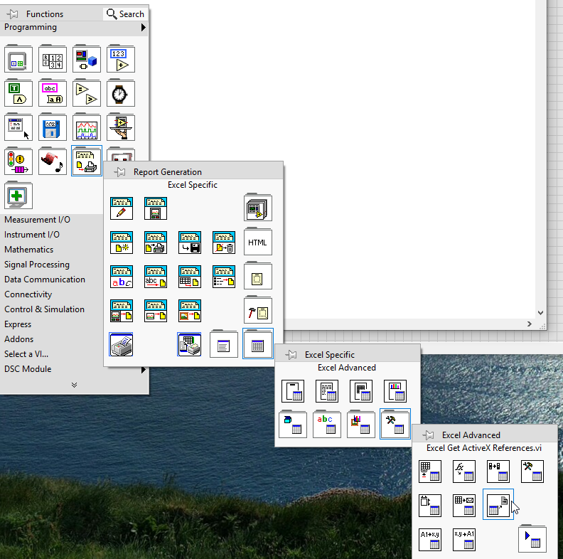

Ah! Well you're in luck. It's not the MOST straightforward thing you can do, but here's how to get the ActiveX references, onto which you can use Invoke and Property nodes to "do stuff":
Report generation -> Excel specific -> Excel advanced -> Excel Get ActiveX References.vi

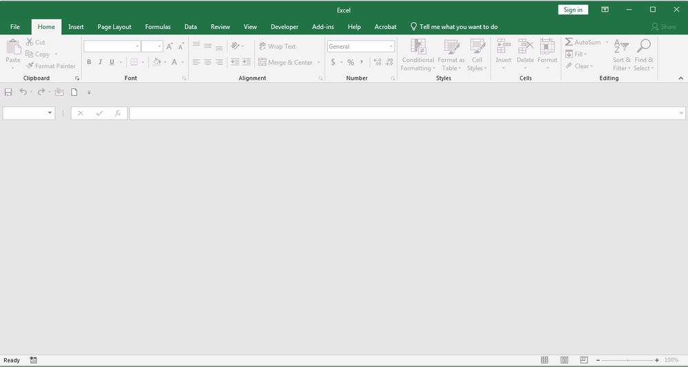

aputman, no dialogs appear. It goes straight into a blank workbook.
One peculiar thing I notice, is that when I close out said workbook at the top right (X), rather than closing the application out, it closes out the workbook and just leaves a "shell" of an application open. It hasn't always done this in the past. Not sure if that's a factor here. Screenshot attached.
