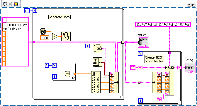

I have an array of 9 elements. One of the element is a timestamp. Each row requires a timesamp. I'm displaying the data on a matrix. I'm not sure if how I can display the timestamp, if I can at all. 7 of the elements are numbers. In the VI attached I used a random number generator to create these values but those values represent analog voltages that will be read from a DAQ device. The other element is a "User Input", which in the attached VI is a number but I would like it if I can have that as a text. I had the "User Input" as a text control before that is why I used the string functions in the VI but I run into the problem of displaying the text in the array (matrix).
I have attached the VI. Below is what I would like the table to look like. I used a matrix in the VI but anything that displays and the data will work.
User_Input     Timestamp    Value_1    Value_2    Value_3    Value_4    Value_5    Value_6    Value_7
TEXT              TIME              NUMER     NUMER     NUMER     NUMER     NUMER     NUMER     NUMER

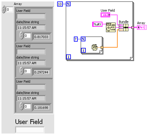

What you want to do is create a cluster consisting of your string, timestamp and 7 values. Create an array of clusters that you can then iterate over and write to disk.
