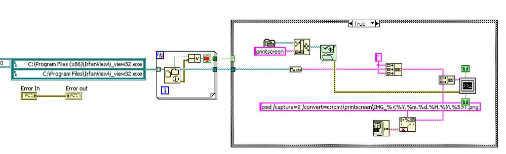

Because it just work with very little coding, I install IrfanView along with my EXE and whenever I need a screenshot I launch a cmd :

I can take screenshots in numerous ways even w/o irfanview, but as the app is not always visible on the desktop or could be (partially) covered by other windows simply taking screenshot doesnt solve my problem. Also I dont need a full screenshot. Having the entire deskop on the image is very undesirable.
See my original post:
"...similarly as if I would select the window of the application and hit ALT+Printscreen. The trick is that the application is not necessarily visible as the operator can minizmize it to the tray or another application can overlay its window. Its size and position can change as well."

use this method put it inside the case structure and start programing to execute in particular time
you just need to adjust the picture size same as your ROI to capture too
