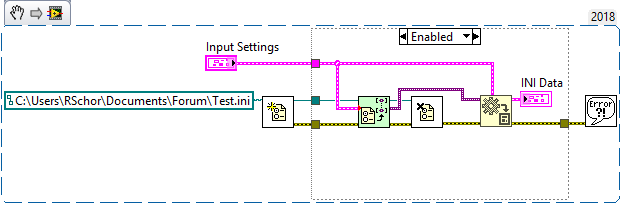

I had not previously noticed the OpenG routines for handling Cluster Data in a Configuration File.  I tried it, and it seems to work!  What I did was make a VI with a copy of your Input Settings Cluster, write a little test routine (shown in the "disabled" part of this Snippet) that did an Open Config Data, Write INI Cluster (OpenG), then Close Config Data.  To read it, I did as shown below.
Worked like a charm.  However, the output Indicator (INI Data) was not "pretty" like the Input.  Suggestion -- when creating Clusters, always right-click them, choose Create TypeDef, and create a TypeDef of the Cluster.  Now if you want to put a Control or Indicator "matching" your Cluster, just plop down the TypeDef you just created!  A little-known "trick" with Cluster TypeDefs is that if you have the Cluster on your Block Diagram (which if it has many components, can take up a lot of Screen Space), if you double-click the edge of the Cluster, it will collapse into its Icon under which it was saved.  This will probably be an "unhelpful" Generic LabVIEW Icon, but if you create your own Icon for your TypeDefs, it will show the Icon you created.  Talk about self-documenting ...
Bob Schor

Hi Bob,
What do you mean not "pretty"?
Message 7 of 20
(5,416 Views)
I'm saving 1000 words (well, about 950 ...)
Not Pretty.pngThe Control on the Left was the Input (from the User), done as a Silver (= pretty) Control, while the Right shows what LabVIEW makes, by default.  Note I did say that the OP should make a TypeDef out of the Cluster, then could use that as the Indicator and it, too, would be "pretty".  Also, there is "hidden" data in the last Cluster element that shows up on the right, but is not visible (not sure why) in the Control on the left.
