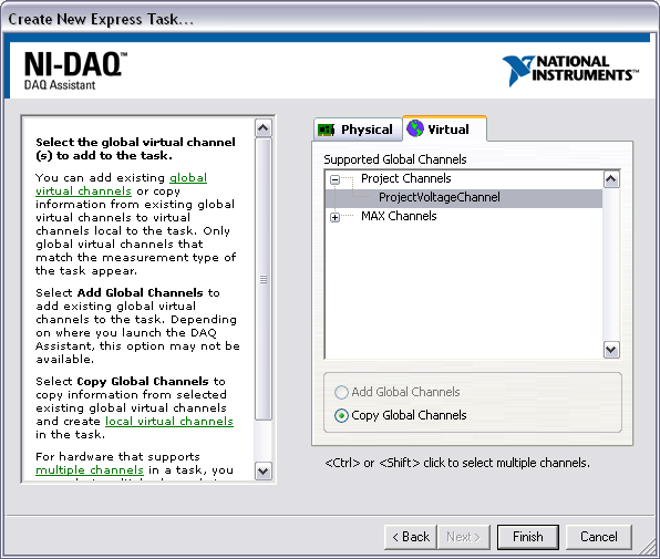

Exporting the scales or channels to file won't help you directly access them from your VI. A VI can access a DAQmx task from one of two places: MAX or a LabVIEW Project. Scales and channels in MAX are global to everything on your computer. Scales and channels inside a LabVIEW project are only valid for VIs in that particular project. Now that you've exported your scales from MAX, you can import them into a LabVIEW project, or you can recreate all these DAQmx items from scratch. Once you add the DAQmx scales and channels to the project, you can add your VI to the project. Then the VI in the project will be able to access those project scales and channels, but any VIs which don't belong to the project will not be able to use those scales or channels. Try going through the following quick steps:
  1. Create a new Project in LabVIEW (File >> New Project).
  2. Create a new DAQmx Global Channel for that project (Right click the My Computer item in the project and select New >> NI-DAQmx Channel).
  3. Go through the DAQmx Assistant like you would in MAX to set up this new channel. After creating it, you will see it appear in your project.
  4. Create a new VI within the LabVIEW Project (Right click the My Computer item in the project and select New >> VI. You could also add an existing VI to the project by selecting Add File and browsing to your VI).
  5. Drop a DAQ Assistant in this new VI. Select the type of channel you created. When browsing to the channel, you can now select the global channel under Project Channels as pictured below, because this VI belongs to the LabVIEW Project which owns this channel.
