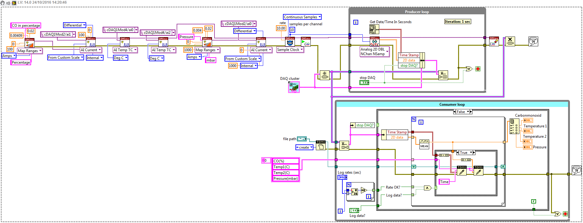

Since you deal with pressure and temperature, I do not think you really need 1000 Hz sampling rate. I would imagine a rate of 10 Hz would be sufficient, and you could average these 10 samples per channel in the Consumer loop before writing to file. I have modified your VI to work in this way. By the way, I think you mixed up some things in your original VI, one example: on the Front Panel you show "Start logging 2" Boolean control under the "Temperature 2" Waveform chart. But you connect the data "Temperature 1" to the File Express VI. Also the same mistake for the "Temperature 1".
What about the Carbonmonoxide signal? Just in case I also included it in the file logging.
Another change is that, the user can change the logging intervals on the fly via the "Log rates" array control.
I have created a LV project, having the main VI and the typdef cluster for data transfer. There is planty of room to improve this VI (like better error handling), please check it if works as required. Note that, I have deleted the serial port code portion, you can add it back to the main VI.

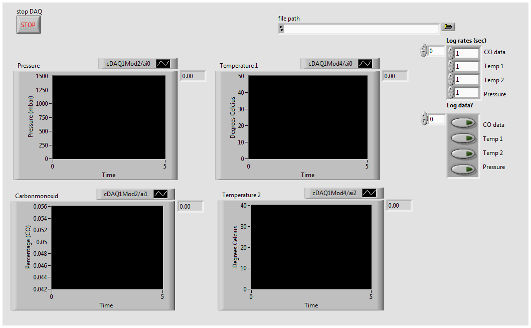

Here is the front panel, and I attached the project in a zip:

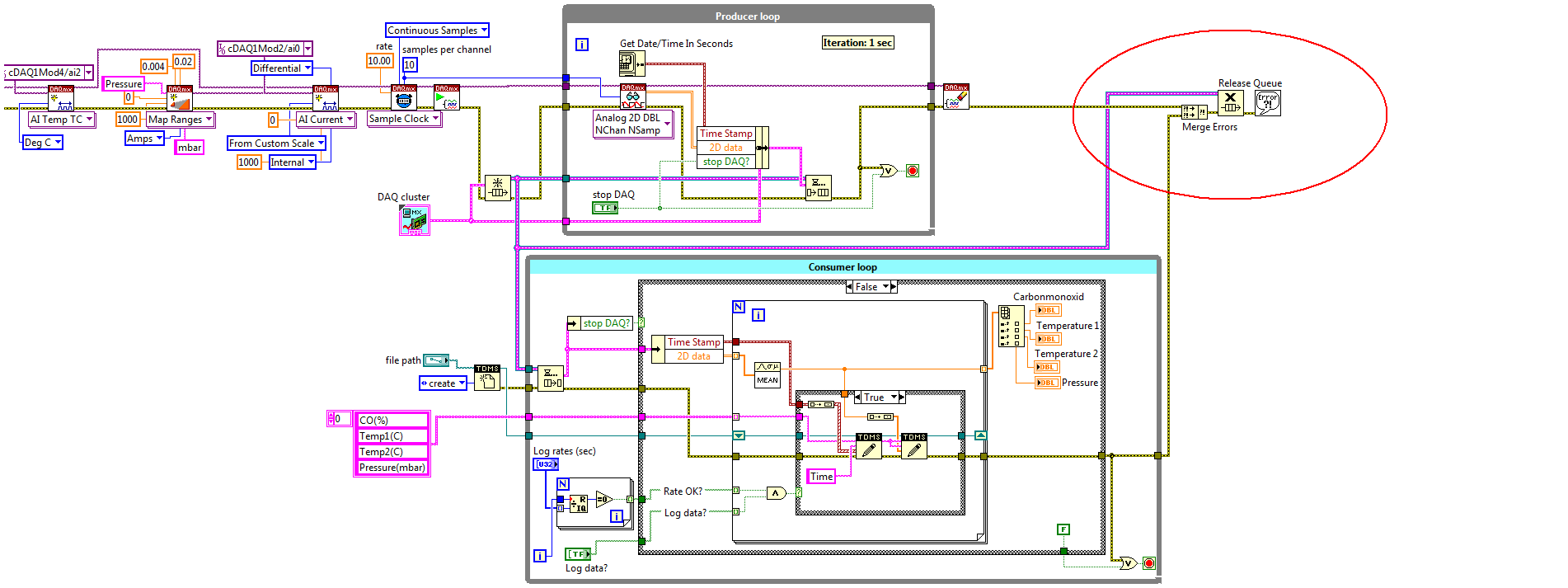

There is a race condition in my code: there is a chance that the VI releases the Queue before Dequeuing the Stop command in the Consumer loop. So modify the VI that the Queue is only released when the Consumer loop stopped:

When I run the VI it seems like it is not reading the data received from the DAQ properly. I get no values at all from my temperature sensors. I will be able to test the other sensor a little bit later but I guess the outcome probably will be the same. Any idea what might be wrong?

Did you set a TDMS File path before running the VI? What happens when you stop the VI via the "stop DAQ" button, any error msg? Put an indicator in the Producer loop, and connect the 2D data into it coming from the DAQmx Read. Do you see new values changing at every 1 second? If so, the problem is in the Consumer loop. Also, right click on the output of the iteration terminal (in the FOR loop inside the Case structure in the Consumer loop), and create an indicator: you should see a value of 3 when you run the VI...
Please give feedback what you see after your checked the above things.

Another thing you need to change! The problem is that, you did not specify file path to record data for the Consumer loop. Do the following:
  1. Go to the Front panel
  2. Right click on the "file path" control
  3. Select "Browse options..."
  4. Selection mode should be: "Files", and "New", not "Existing"!
Now you can specify a path and a file name for the TDMS file BEFORE running the VI, like "Data_1.tdms".
What happens when you try this?

You were completely right!
I forgot to set the filepath and that was the problem. Everything works like it should :D. I just tested the pressure sensor and it is working like a charm! I really need to understand how this exactly works and hope that you maybe have the time to give me some understanding. I will work with it over the next couple of days and then return with some questions. It just looks wonderful.
I have one more little request. I know that you mentioned that I should just put the serial port code back into the main VI but if I want to be able to save the data in the same file just like with the other sensors. Could you maybe help me with that aswell?
I did not see your last post before I posted but I found out that I had to change the mode so it creates a new one instead of looking for an existing.
