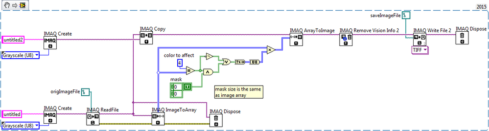

FWIW, here is the VI I'm using to do the image modification.  I used IMAQ copy to try and "inherit" some of the TIFF tags from the original image.

Write out that Boolean logic.
Pretty sure it can be done easier and more efficiently.
