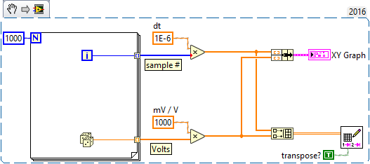

Perhaps the text description is a little confusing, but I already explained how to convert your data to the units you requested. Here it is in picture form:

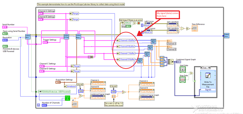

The concept is not confusing. There is a difference between the way my data is provided and the example you have given. The picture below shows where my data comes from. It may be to the lack of knowledge, but I am unable to "Unbundle" the data by its x and y values to be able to perform the conversion. In your given example you have both the x and y values separately and then it looks like you bundle them together after the conversion has been made and then save/ graph the data. I don't see a way to accomplish this in my scenario and that is what I need help with.  Ex pic.png

I see, I think if you create an array of time values, you will be good to go. Look into the "Ramp Pattern.vi" to make it easy 🙂
A couple of tips:
  • You  only need 1 "unbundle by name" per wire, you can expand it by dragging the bottom.
  • I would not use dynamic data, because it obscures the code. In this case, "build array" will work.
  • I would also not use "write to measurement file", because "write delimited spreadsheet" is very easy to swap in.
