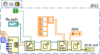

Hi Frederico,
prepending the array size allows you to read this information from your file - either on your own or have ReadBinaryFile do the work for you:

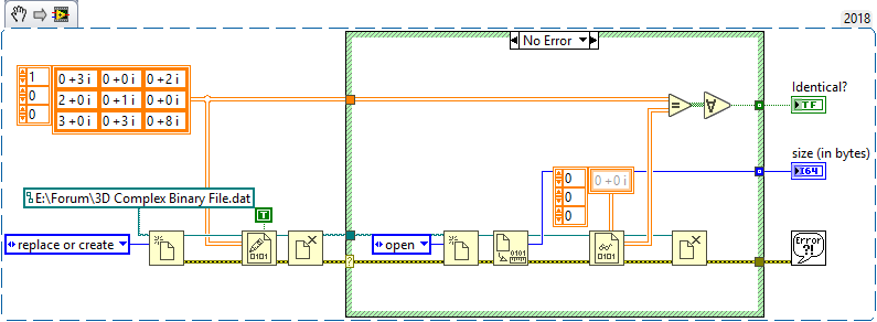

Frederico,
     I've taken the liberty of rewriting your VI (using LabVIEW 2018, but I suspect the results will be similar in earlier versions).  I've simplified some of the steps by using defaults, didn't use some functions (like Deny Access, as I assumed you were not multi-tasking here), and used the Prepend Array Size so that LabVIEW would be able to reassemble the Array knowing the order and size of its dimensions.  By writing and testing a little Demo routine such as this, I was able to remind myself of some "facts" about multi-dimension Array I/O I had forgotten (I've rarely used more than 2 dimensions in an array).
     Here is my VI:
3D Complex Array Binary File I/O3D Complex Array Binary File I/O
The first part is essentially your code, but with the Prepend Array Size switch turned on.  Assuming there are no Errors, I re-open the file, ignore the file size, and tell it to read in a 3D Complex Array, namely the thing that I wrote!  And guess what -- it returns a 3D Array, which I then compare (using Equal?) and ensure that all of the (3-D array of) Booleans are True, meaning I read in an exact copy of the Array I wrote out.
Bob Schor
P.S. -- For a little more fun, try writing more than one 3D array, and then attempting to read them in "all at once" (instead of one-at-a-time).  Be sure to look at what comes out -- hint, it is not a 3D Array, and is also not a 4D Array (try to understand why NI/LabVIEW chose this reasonably-logical Data Structure for this output).
