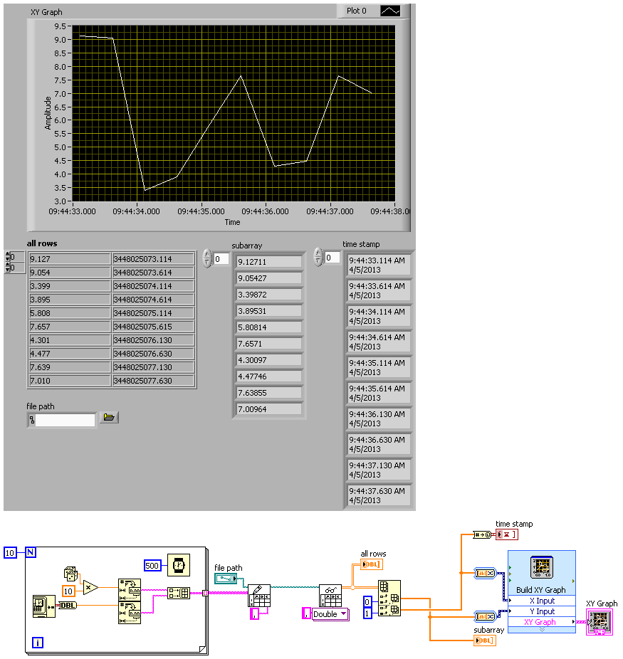

i was looking at your programs and trying to make sense of it all...i cleaned it up to a compact version of what you are trying to do. save the file as a .CSV delimeter. see if it makes any sense?  Smiley Wink

thanks:)
do you know is it possible to see, more time datas on X axis, not just 3 points but more..
best regards

@alican wrote:
thanks:)
best regards
yes, display format time x-axis drop down box for custom time format at the graph properties...
