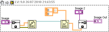

You can save it as a byte stream : convert to a 2D-array (SGL) then save. Of course reading the image will requires the reverse operations.

MikeBoso a écrit :
Whoops, I forgot to mention a key detail in that the images would need to be viewed by users without LabVIEW.
When wonky stuff is observed we use ImageJ for image manipulation.
That was indeed a key detail. Have you had a look at the TIFF format. I know that TIFF can handle FP images, but I don't know if there are the corresponding readers (Photoshop ?). Of course, you'll have to develop your own file saver, since IMAQ vision TIFF file save is restricted to integers.
