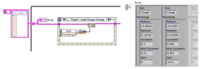

If both scales change during the zooming, you get two successive events, one for x and one for y:
(1,664 Views)
Wonderful!  Thank you
