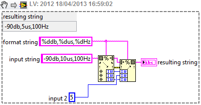

One of the many possible ways:
Hope this helps.

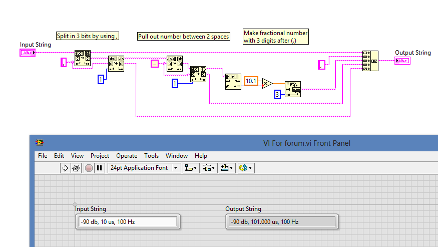

Hi Thais
You can do something like this
1) Split string up in 3 bits by using the ,
2) Pull out what is between the 0 spaces og the middle string
3) Change this to a floating points tring with X number of precision
4) Build the string back up.
I have also attached the example in LabVIEW 2012 format.

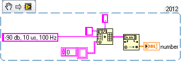

Use the 'Spreadsheet String To Array' then 'Fract/Exp String To Number' to give you an array of floats from the Excel spread sheet.
You can then pick and choose which item you need or skip over or replace.
I used a float because db and hz could be given as floating point

Hi Omar,
is there a reason to use two functions when one will do the same?

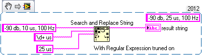

If all they wished to do is change the 10 us then the search and replace with regular expersion turned on will work.

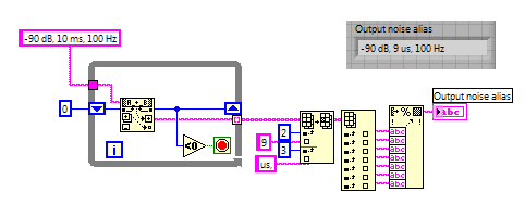

I just realized that is possible that not necessary the string that is been read will be given in "us" because allows that you type in "ms" also.
So here goes my not-so simple solution: (with B capitalized :P)
