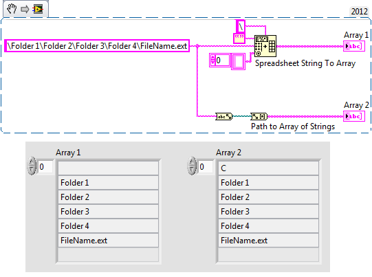

RavensFan suggested the appropriate function for your requirement, however you can also use an alternative, which is 'Spreadsheet String To Array'.
Strings from path
