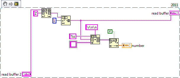

Change the interpretation to use a String to Array, and don't forget to remove the 1st 'Z'. See attachment.
