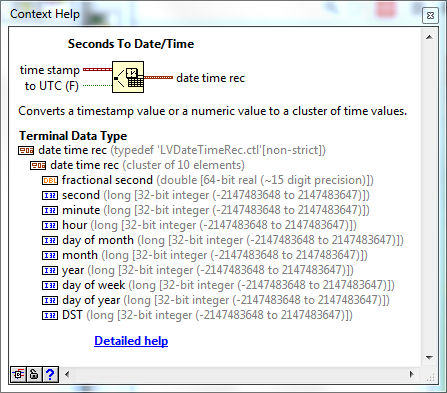

There is no need to format the timestamp into a string and then compare strings.
Use the Seconds to Date/Time function:
This will give you a cluster representing the current time.  You can compare this to the time interval you want things to happen at and then execute code based one that (i.e. if you check to see when the minutes is equal to zero, you can execute code every hour (but make sure you check every 30 seconds or so if you use equals so you don't miss it!)).

Yeah that's the one I was looking for. I could not find it the last few times I needed it so I went back to my old ways of using Format Date/Time String. This really needs to be named something more descriptive...

I totally agree!
I'd been using LabVIEW for almost 3 years before I realized what this function actually did and how useful it was.  Life without it is harsh....
